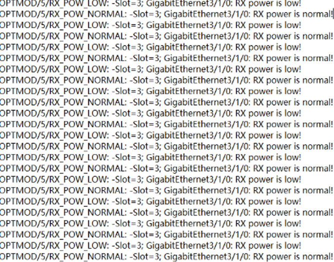

1. View the diagnostic information display logbuffer and find that the interface has multiple alarms and has been fluctuating.

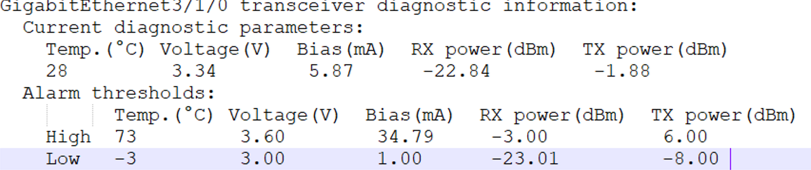

2. Check the diagnostic information, which shows that the received optical power is low, with a threshold of -3 to -23.01, currently at -22.84. Once it exceeds the threshold, an alarm will be triggered.
