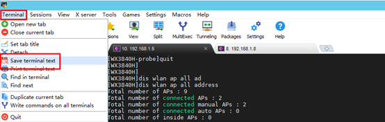

5.      Save session records to a local folder in the terminal software:
For example:
Solution
According to the above method, the diagnostic information of the AP can be exported without the need for a console cable to connect to the AP.
