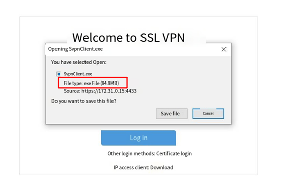

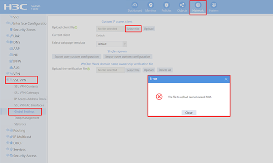

The customer wants to upload the latest inodeclient.exe to the web of sslvpn gateway, but the web limits the maximum upload file size to 50M or 80M.
Process Analysis

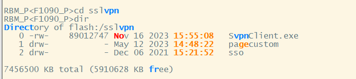

Upload the client software to the local flash of the device: /sslvpn/SvpnClient.exe (note: the directory and file name must be consistent), restart the device, trigger the software to initialize and load the client in this directory, and the size will not be checked at this time.
Solution
See the process analysis method for details. You need to restart the device after uploading to take effect.
