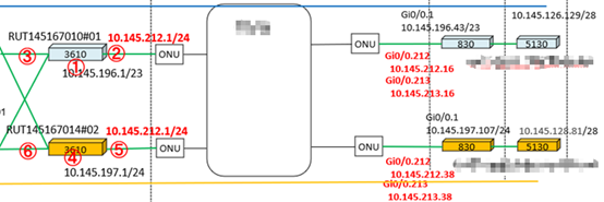

Network Topology
In the figure below, RUT145167014#2 on the left and 830 (RUT145128081-01) marked yellow on the right establish IPsec.
