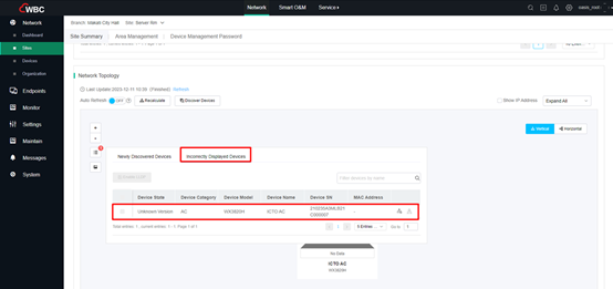

When adding AC in WBC, Device State shows Unknown Version, and AC is offline:

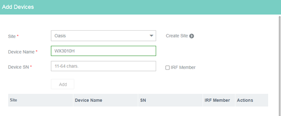

2. Add a device from the Oasis platform
A.     From the left navigation pane, select Network > Devices.
B.     Select a branch and a site.
C.     Click Add.
To obtain the serial number of the device, see the label on the device, or access the device form the console port, and then execute the display device manuinfo command.
Figure 1 Adding a device
