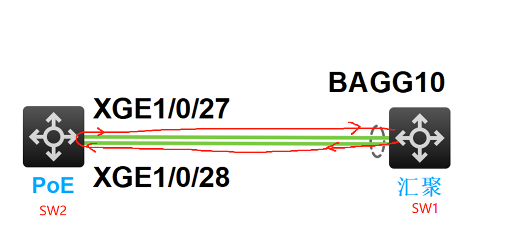

AP1--SW1==SW2--AP2   staticlink-aggregation between SW1 andSW2
Problem Description
when AP1 send a arp broadcast, it will receive the arp back; when AP2 send a arp broadcast, it will not receive the arp back.
There seems to be a one direction loops.​

  The detailed analysis of this process:
1. The aggregated BAGG10 is the root port, continuously sending BPDU (Bridge Protocol Data Unit) messages to XGE1/0/28 (with F=1, L=1, TC=0 in the Flag field).
2. Due to networking issues, the PoE (Power over Ethernet) considers XGE1/0/28 as the upstream link and XGE1/0/27 as the downstream link. Therefore, it continuously sends BPDU messages to BAGG from the root port XGE1/0/27 (with F=1, L=1, TC=0 in the Flag field).
3. When the aggregation receives BPDU messages from XGE1/0/27 (with F=1, L=1, TC=0 in the Flag field), it considers the priority of the message lower than its own and not a normal root port negotiation BPDU message (F=1, L=1, TC=1). This triggers the dispute mechanism, stopping the forwarding of traffic. It then sends BPDU messages outward (with F=0, L=0, TC=0 in the Flag field).
4. When XGE 1/0/28 receives BPDU messages (with F=0, L=0, TC=0 in the Flag field), it immediately responds with the normal BPDU message (with F=1, L=1, TC=1 in the Flag field), resolving the dispute. Normal traffic forwarding resumes.
This cycle of events repeats continuously. The time from 3 to 4 is short, and the time from 4 to 3 is long, allowing traffic to be forwarded.
This issue essentially causes a loop in the broadcast traffic from SW1 to SW2, resulting in the AP receiving its own ARP packets. There are no issues with the broadcast traffic from SW2 to SW1.
Solution
root cause:  sw2 static link-aggregation configuration missing.
Solution: configure static link-aggregation for XGE1/0/27 and 1/0/28
