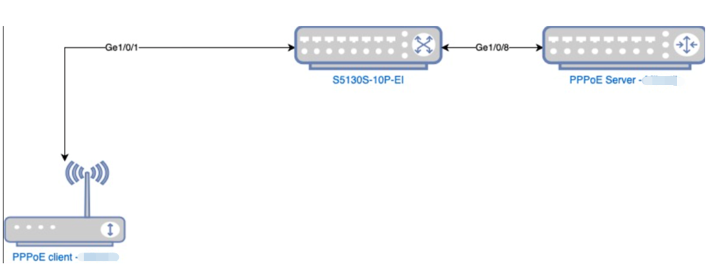

Network Topology
Problem Description
Our S5130S-10P-EI is used as a PPPoE relay, and the PPPoE client after the device cannot establish a connection with the server.

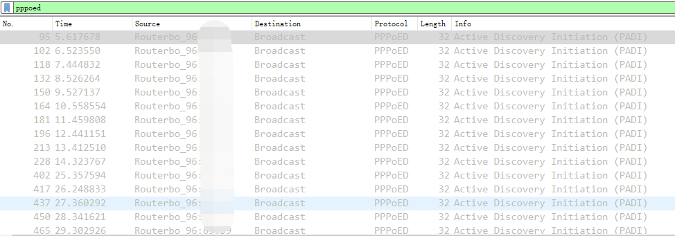

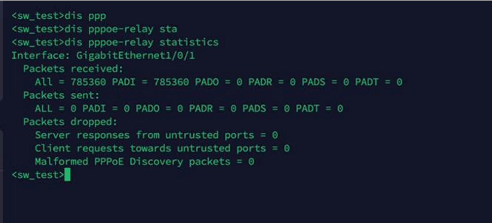

2. Capture of packets reveals that the device receives PADI packets but does not send any packets to the PPPoE Server.
3. It has been confirmed that the Trust interface has a different vlan from the client-side receive port, which requires the same vlan, and does not support crosslayer three.
