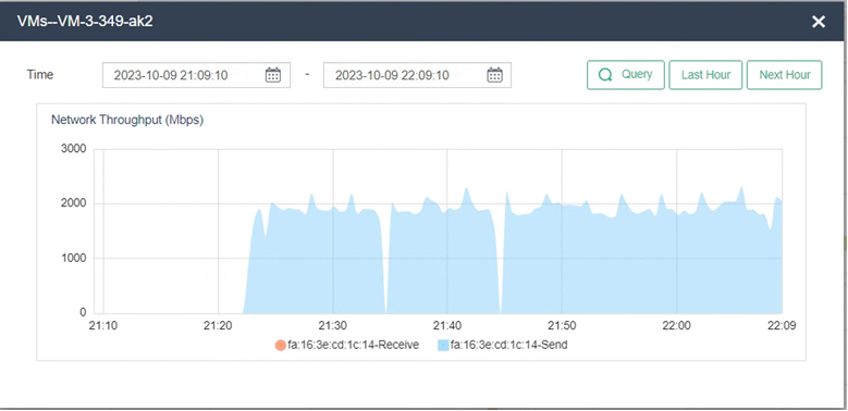

Customer found VM send huge traffic to internet over the bandwidth to ISP, then leads to congestion.

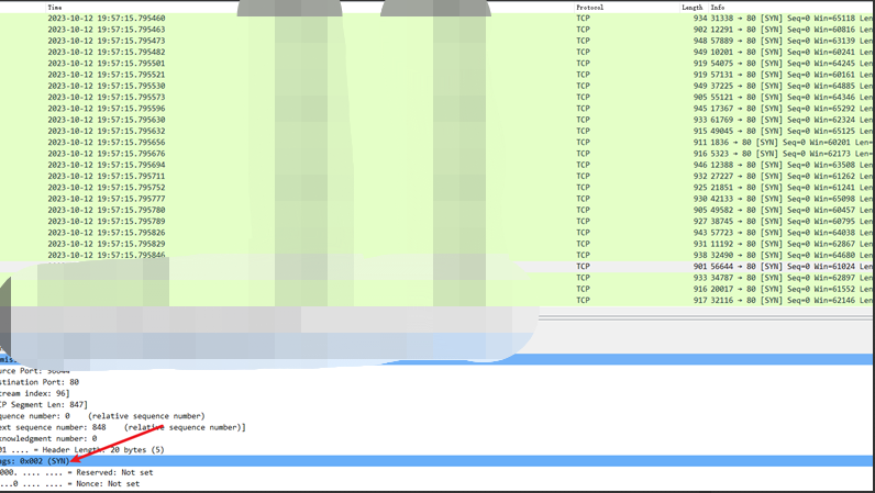

So we capture packet on the relevant port to check the traffic detail.
We found there is too much SYN flood traffic.
