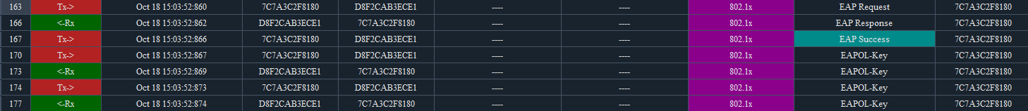

1. Debugging the AP ar5drv , we found that the client can normally complete 802.1x authentication, as well as four handshakes.

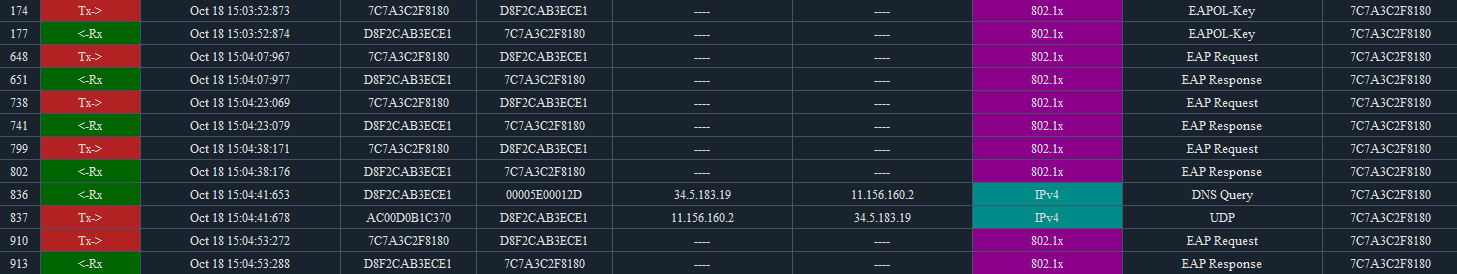

2. In the subsequent presence of EAP Request/Resonse at intervals that are different from regular 802.1x authentication, and at the end the deauth frame is sent by the device.
3. I troubleshooted the service template configuration and eventually found the dot1x handshake enable and dot1x re-authenticate enable commands, both of which are usually not enable by default.
① dot1x handshake enable
② dot1x re-authenticate enable
Both of the above commands will send a message to the terminal after the client has been successfully authenticated, both of which will detect the user's online status. However, because the device does not reply to the user any more after a successful handshake of dot1x, causing some clients to re-authenticate or go offline after a period of time.
