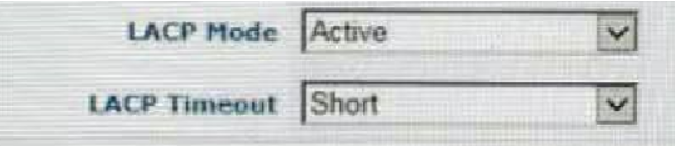

Upon checking the configuration of the peer device, it was found that the peer device was configured with a short timeout, as shown below:
Our device defaults to a long timeout. Inconsistent timeout times on both ends result in frequent UP/DOWN on the local port.
