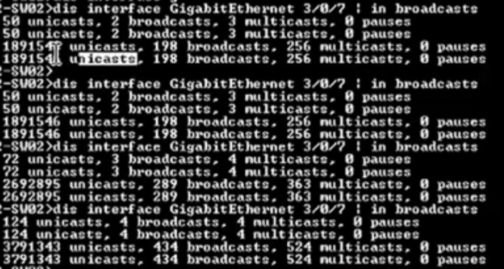

Through continuous use of the "display interface" command to inspect packet counts on the interface, we observed that the volume of abnormal unicast packets sent from the switch to the AP was approximately 2 million packets per second(pps).
It had been found a large number of abnormal unicast packets, being sent to the AP in the VLAN 10, causing disruption to normal AP operations.
