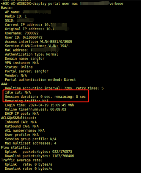

3. The debug"s Error code is displayed to indicate that the AC device is telling the Portal Server that this link has been established.
4. After the customer deletes the Portal table entry, the terminal can connect to WiFi normally.
5. Verify the terminal verbose message and find that the idle-cut time is not set.
Solution
The problem is solved after configuring idle-cut time, and it is recommended to configure it in 1/3 of the DHCP lease.
Idle-cut command:
[AC]domain xxx
[AC]authorization-attribute idle-cut 10 10240
