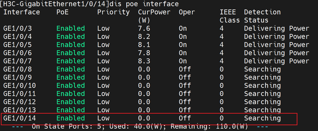

1.       First, use display poe interface to check the power supply status of the AC. In the following figure, the 1/0/14 interface is connected to an AP 60m away:
The picture shows that the interface is not supplying power to the AP.

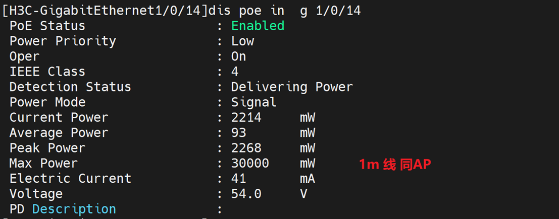

2.       Next, use a 1m long cable to connect to the same AP, and verify that it can be powered normally.

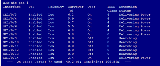

3.       R&D laboratory test, the versions are consistent, AC can use 100m network cable to power AP, as shown in the following figure, 14 ports of 6126 connected by 100m network cable:
