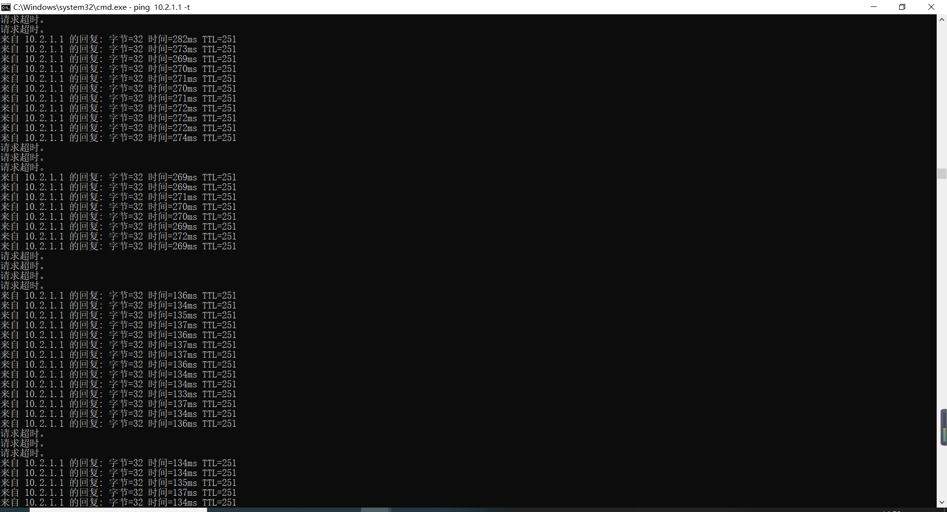

Ping lost while from the local private segment to the remote provate segment

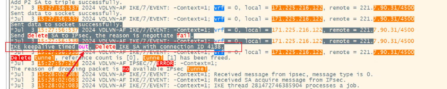

1. ike sa normal
2.ipsec sa normal
3.debug ipsec and ike found the ike keepalive timeout
