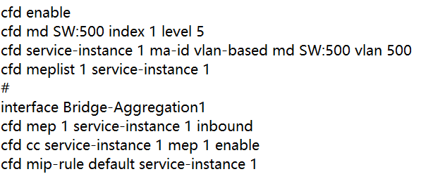

1.H3C side the lose the MA name configuration,
cfd service-instance 1 ma-id string MA1 md SW:500 vlan 500

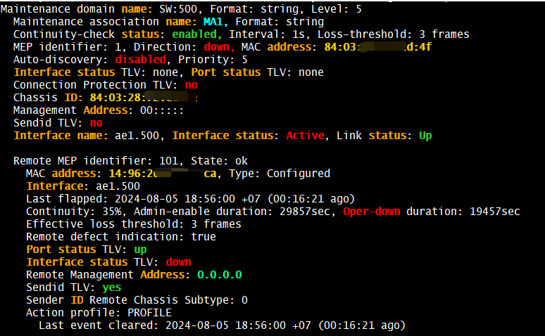

2.on JNP device can show the status of the MEP,
but H3C side there is no MEP shows,
3. need change the instance id from 101 to 1 on H3C device
