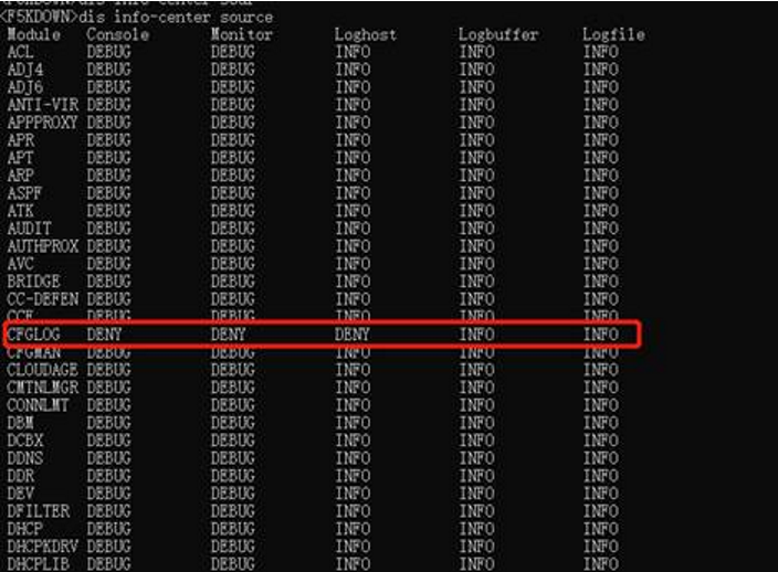

Select to output logs to the log host, but the firewall will not send CFGLOG module logs.
Process Analysis
1. Check the default output rules of log information. By default, the log host will output all supported modules at the informational level.
2. Check the display info-center source output. The level of CFGLOG output to Loghost is DENY. Therefore, it cannot be output to Loghost by default. Need to manually configure info-center source CFGLOG loghost level informational command on the firewall.
3. Normal output after manual configuration.
Solution
Manually configure the info-center source CFGLOG loghost level informational command on the firewall
