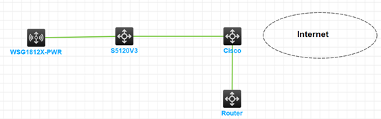

Network Topology
Refer to the blow topology:

Customer testing shows that S5120V3 accessing the public network and gateway has no delay, and Router accessing the public network and gateway is normal, but there is a delay when WSG accesses the gateway.

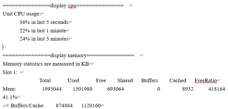

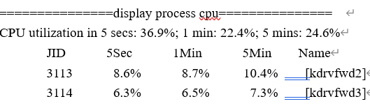

Then the CPU, memory, processes, etc. of the device were checked and no abnormalities were found:

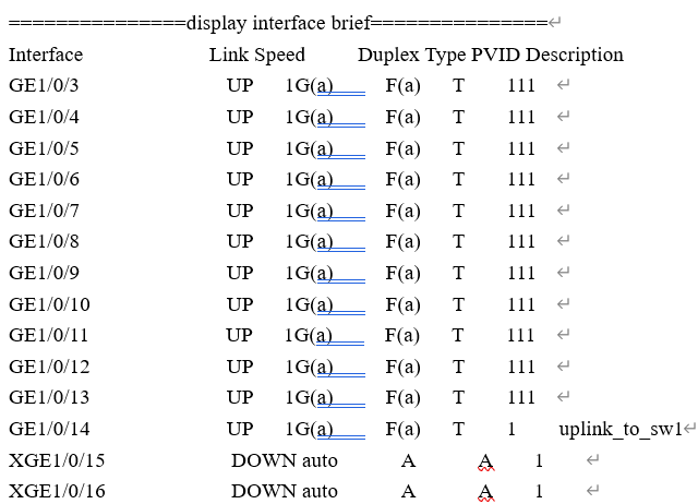

After checking the forwarding process, it is relatively high, but theoretically there should be no delay, so it is suspected that the occasional high traffic caused it; it can be seen that all GE ports of AC are up, it should be all connected to the device, which is different from the networking description, all traffic needs to be forwarded by AC, so it is recommended that other devices connected to AC can be connected to SW, then, it is currently possible to consider changing to local forwarding, and then doing second-layer isolation based on VLAN.
Solution
The issue was solved after several APs were moved to Switch from AC.
