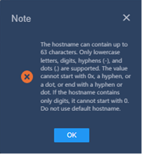

When you want to add a host with default-hostname it will shows this note.
Figure 1
It can be easily change the hostname and restart the matrix then the plat can be installed normally.

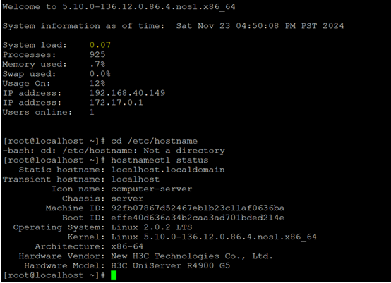

1.      Use this command to check the hostname of the host hostnamectl status
And if the name is localhost.localdomain that means you need to change it.
Figure 2
2.      Use this command to change the hostname permanently.
hostnamectl set-hostname <hostname>
The hostname needs to obey the rule shown in Figure 1.
