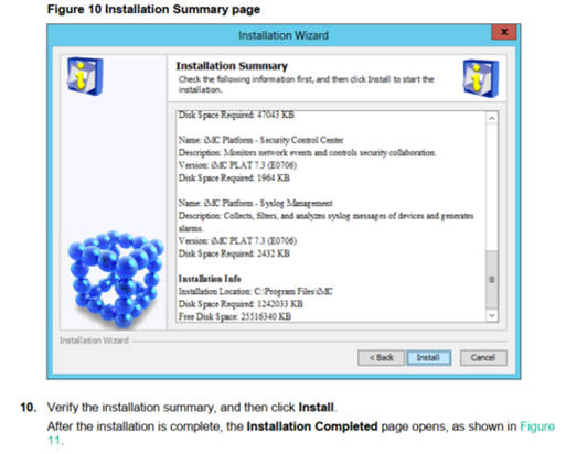

When installing MySQL, the following error occurs when the page leads to a confirmation of the installation summary and then clicks Install.
Begin to install database and data...
    Begin to create config_db foreground tables and data...
ERROR 1118 (42000) at line 1441: Row size too large.
The maximum row size for the used table type, not counting BLOBs, is 65535.
This includes storage overhead, check the manual. You have to change some columns to TEXT or BLOBs
unzip :script/plat_db_mysql_v7r1b06d28tov7r1b06d28sp01_en.sql
