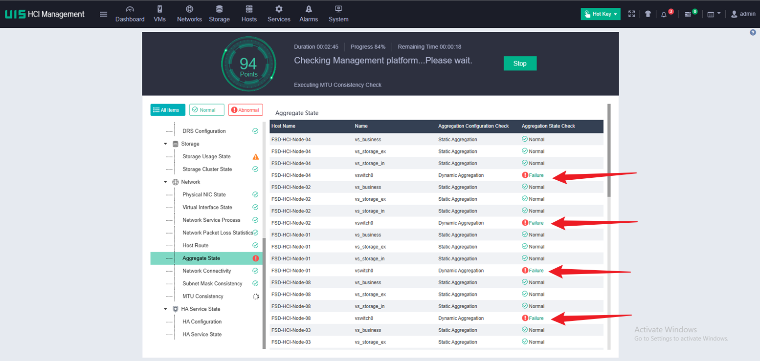

UIS hot key checking environment health status prompts aggregation status failure
Process Analysis
After checking, the physical network interface of vswitch0 on the UIS side is using the dynamic aggregation + basic load sharing operating mode. Normal, connected switch ports, also need to be aggregated and dynamically aggregated. If static aggregation is selected, it will not work.
So we checked the port aggregation on the switch
[H3C] display link-aggregation summary
We found that although the ports are aggregated, they are using static aggregation, so it does not work.
Solution
Modify the switch port aggregation mode to dynamic aggregation.
