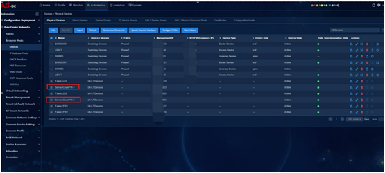

Single-lag firewall connect to the one of spine.

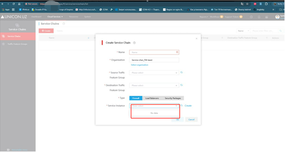

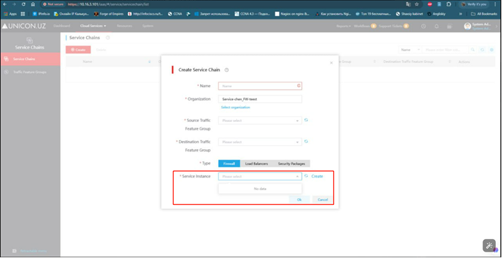

After manually managing the east-west service chain firewall on ADDC, creating a service chain on CloudOS cannot see this resource:

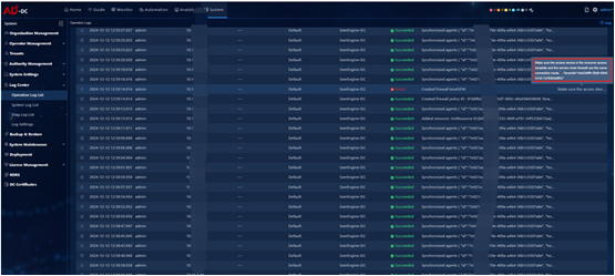

No error logs on ADDC:

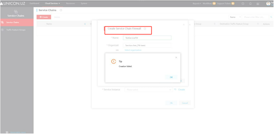

Failed to create firewall:
There are no errors reported in the operation log on ADDC, and the CloudOS operation log also shows a failure to create resources.

The service chain names on CloudOS and DC need to be consistent, otherwise they cannot be created.
After modify there is another error pop up.
Make sure the access device in the resource access template and the service chain firewall use the same connection mode.        -Tenant
