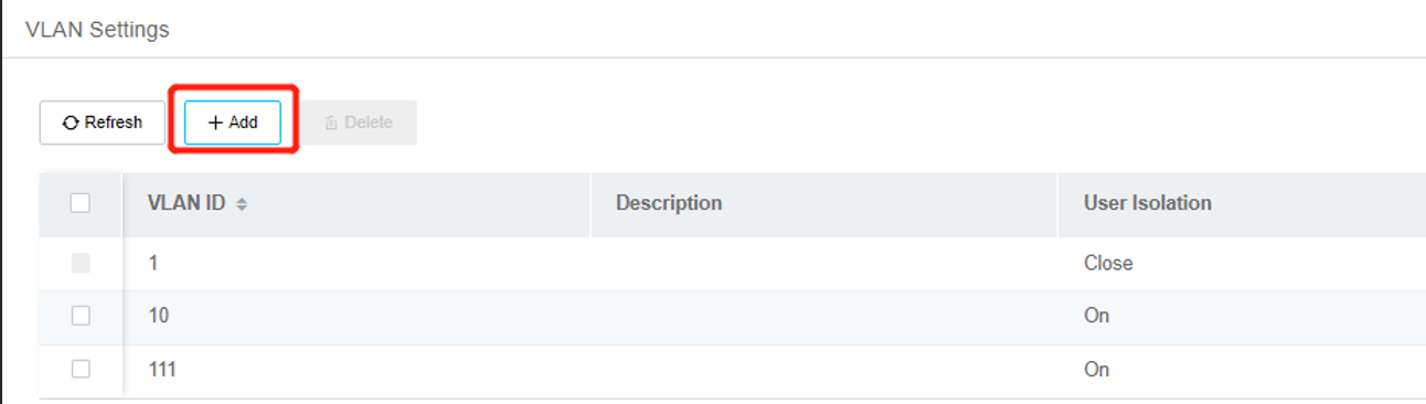

Modify the AP management VLAN to another VLAN (not vlan1), and Cloudnet clears the VLAN configuration after the AP goes online.
Process Analysis
When using non-vlan1 as the management vlan, need to configure the relevant vlan on Cloudnet, otherwise it will be smoothly overwritten by the Cloudnet configuration after going online.
Solution
Create the corresponding VLAN under the Cloudnet VLAN settings tab, and Cloudnet will not clear the VLAN configuration.
