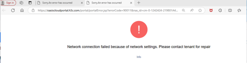

Problem Description
Using Cloudnet one-click authentication, the following error message appears after the terminal is connected to WiFi, and the URL error reason is 90011.
