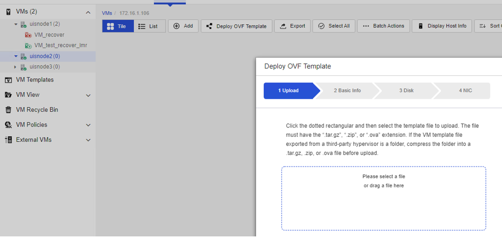

Try to import VMware's .OVA file fails, prompting that the file decompression failed, import the OVA template as shown below:

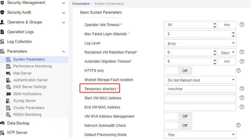

First check which temporary directory is in the system parameters:

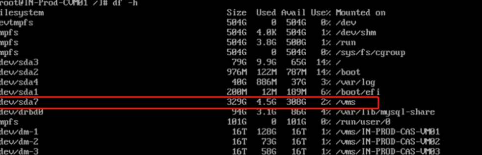

Then check the space size of the temporary directory, the size of the ova file deployed on site is 176GB, and the available space in /vms/tmp is only 308G:
