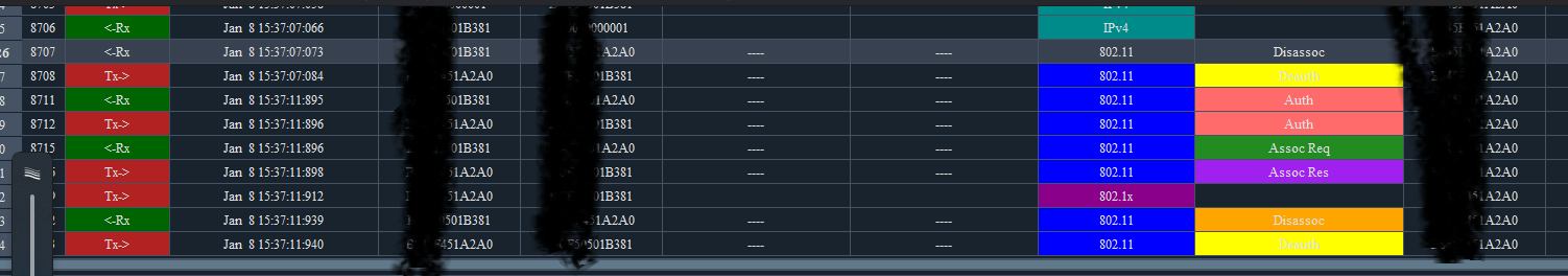

4. Capturing debug ar5drv for radio 1 on the AP shows that the terminal actively sent a Disassoc message, and subsequent authentication attempts also fail

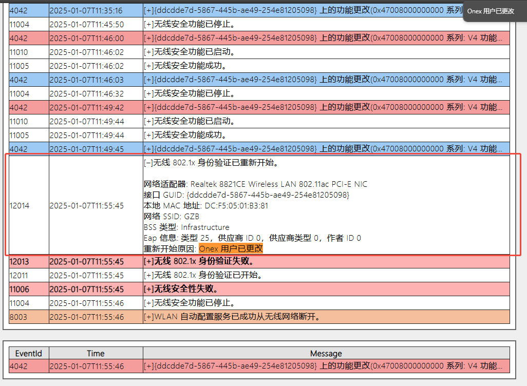

5. Therefore, further capture the wlan-report-latest report of the terminal. The fault time point shows that 802.1x identity verify has restarted, with the reason being: Onex user has changed (OneXRestartReasonOneXUserChanged 802.1X verify restart is the result of user change. This may occur if the current user logs out and a new user logs in to the local computer).

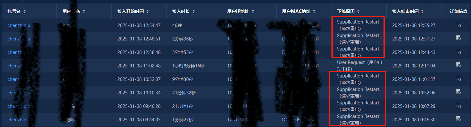

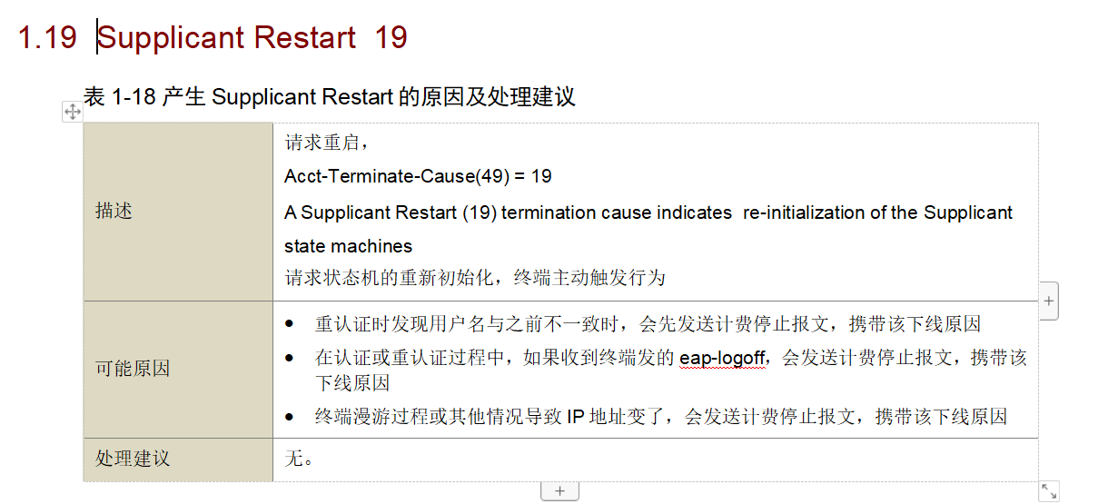

6. Check the offline reason on adcampus as [request restart], which also indicates this is an action actively triggered by the terminal. There are three possible reasons, as shown in the following two images.

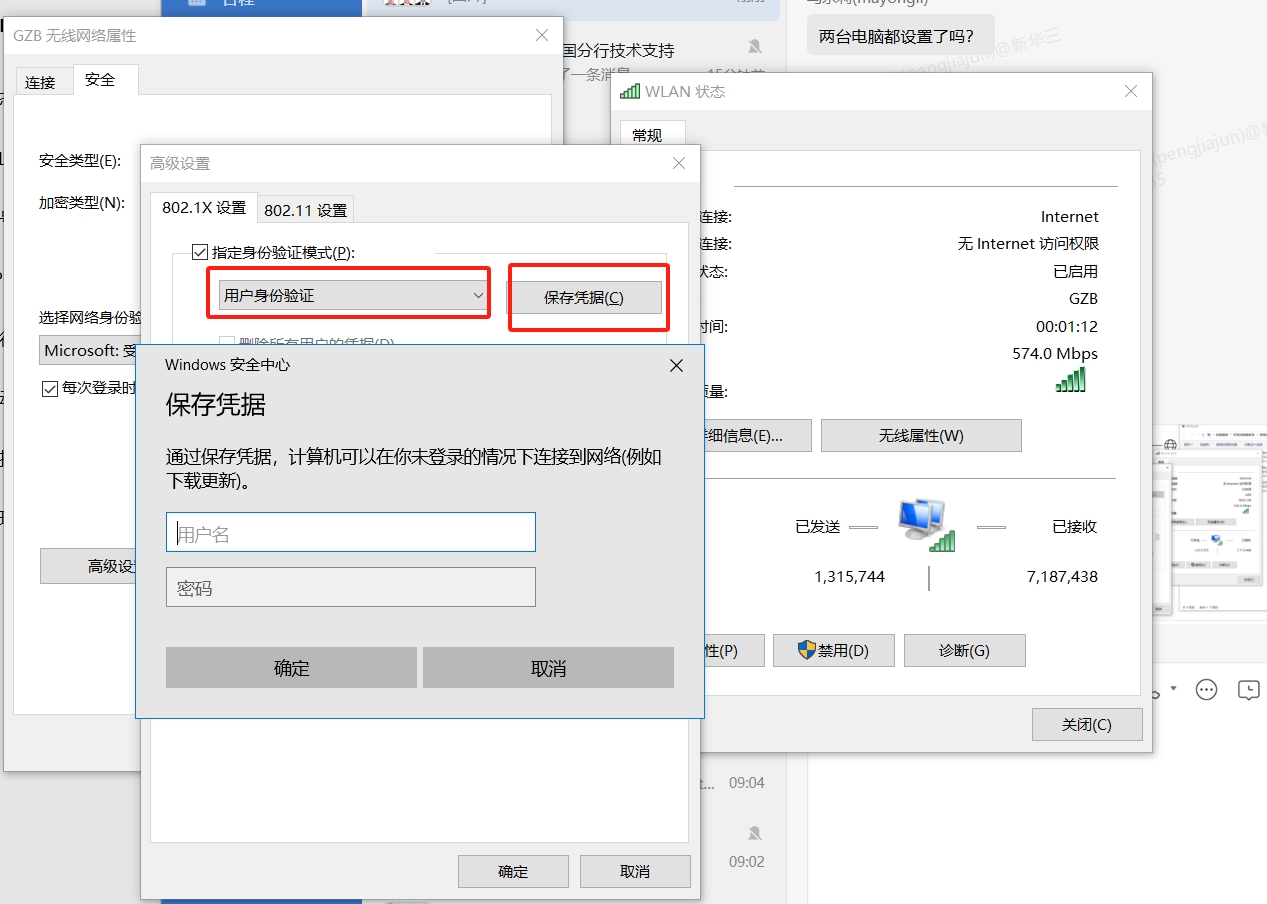

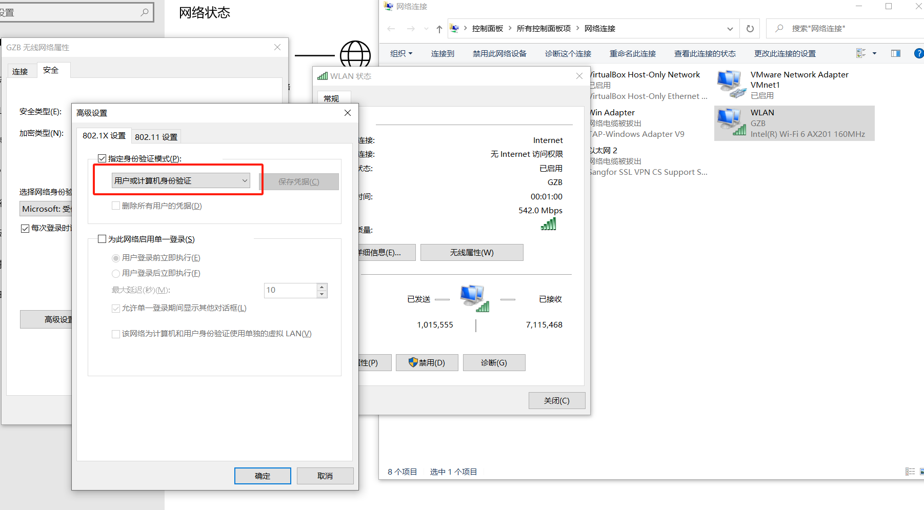

1. Workaround: Temporarily identified as a Windows mechanism issue. Change the following to user identity verification, then save 1x account credentials. Only the remotely accessed computer needs this setting; the initiating computer does not.
2. Additional testing: The issue persists when using our inode.
