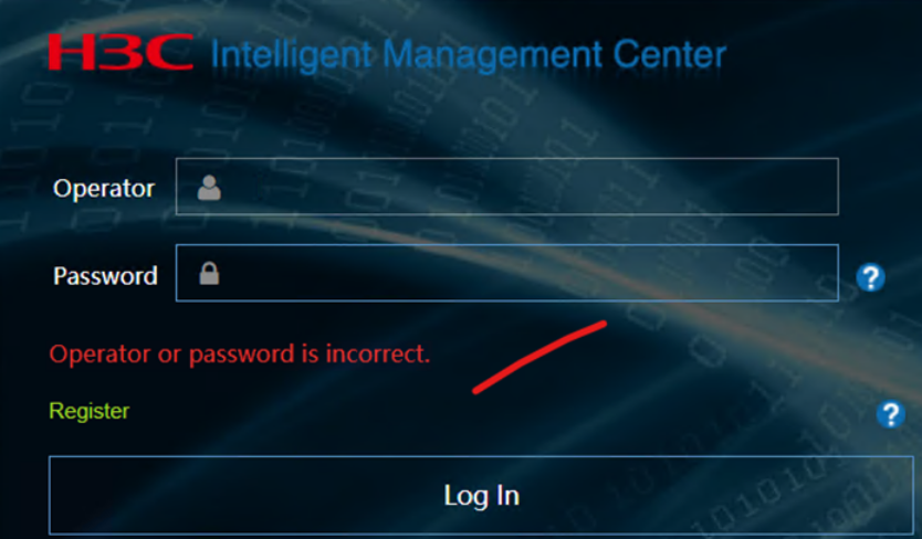

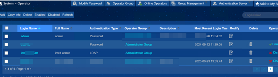

LDAP users cannot log in to iMC, when logging in using LDAP users, it prompts that the account and password are incorrect.

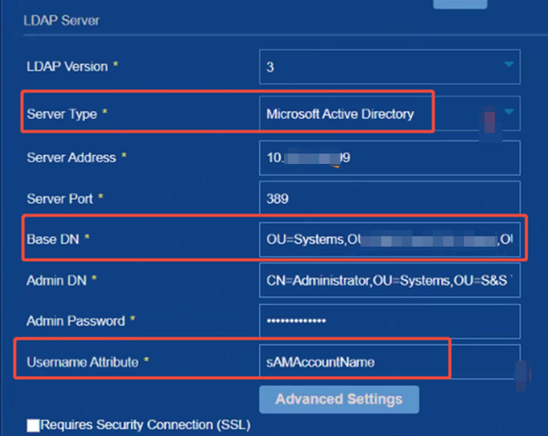

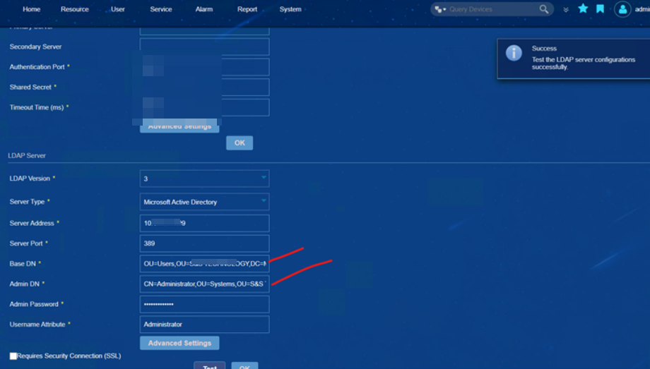

1. First confirm that the user and password are correct;

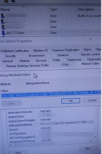

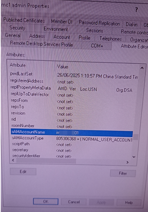

2. Check whether the LDAP server is configured correctly;
3. Then check whether the user attributes and Base DN on LDAP are correct.
Solution
After comparing with the information on the LDAP server, it was found that the attributes and Base DN were wrong. After modification, the problem was solved.
