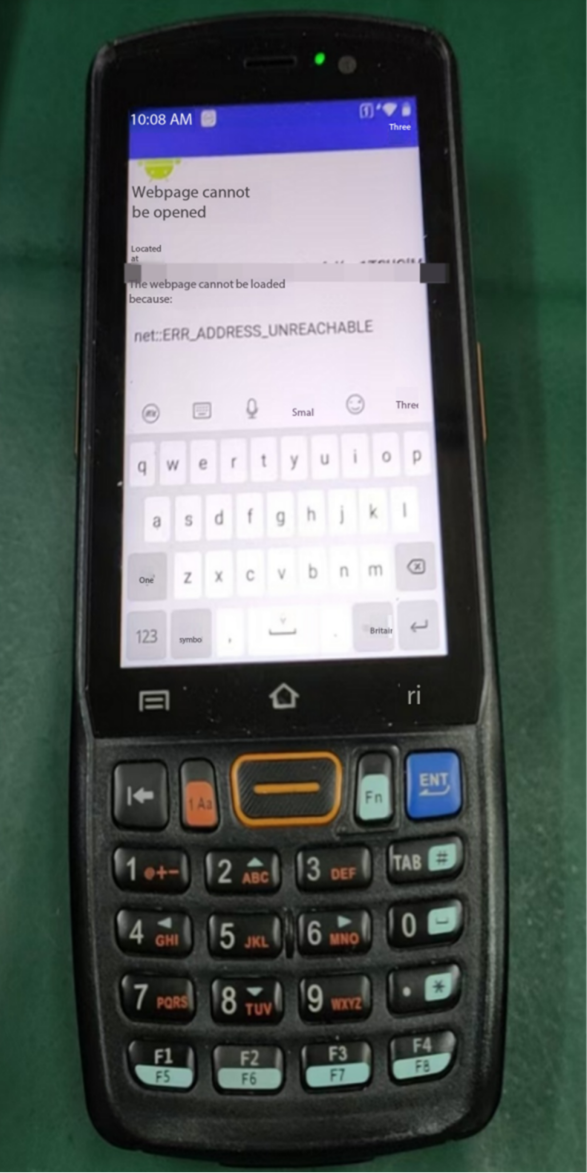

When the PDA connects to our company's wireless network and scans the QR code to transfer files to the internal HTTP server, intermittent disconnections occur. During disconnection, the PDA web page reports a net::ERR_ADDRESS_UNREACHABLE error, but the PDA shows full wireless signal strength.
