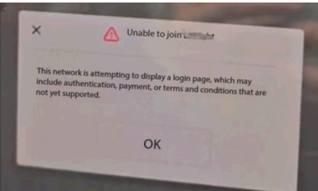

Problem Description
On-site reports abnormal error when connecting to outdoor AP

2. Collect debug information, error reported as Failed to access client because this radio needs load balance.
Solution
According to the debug error message, after disabling wlan radio-load-balance overload-5g ssid-hide enable, terminals can connect normally
