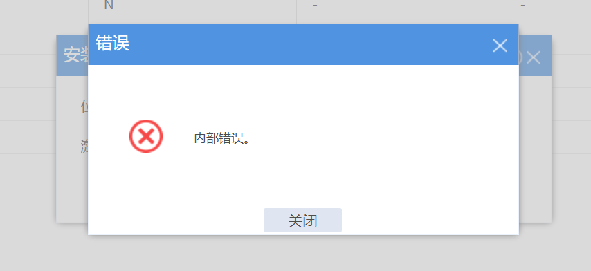

Problem Description
On-site import of M9000 IPS authorization. Uploading the AK file on the WEB page prompts an internal error. Screenshot as above.
Process Analysis
Redownload the DID/AK files from lmp.h3c.com, acknowledge the integrity of the DID file uploaded via the webpage and the downloaded AK file, both are correct
Tested by replacing the browser, the issue persists
Entered the command line to prepare for uploading the AK file, found insufficient flash space. After clearing the flash space to 50M remaining, returned to the WEB page to upload, authorization and activation succeeded
Solution
Before authorizing activation, acknowledge the remaining flash space to avoid uploading when flash space is full.
The firewall WEB page does not display the error reason for authorization activation. You can switchover to the command line to try.
