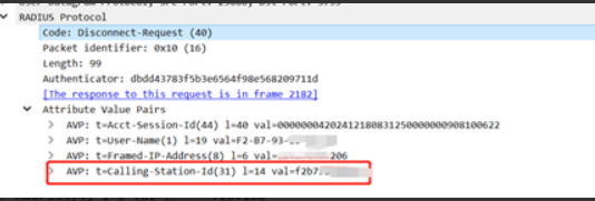

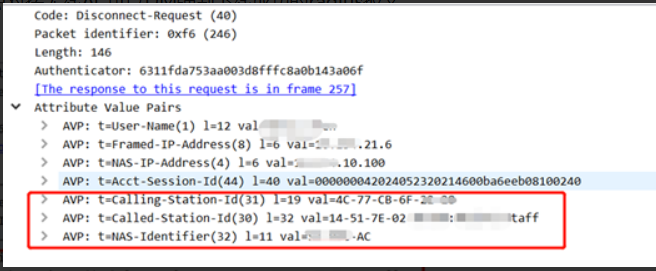

2、Compare the radius packets from other sites where wireless AC successfully forced users offline via DM:
Successful cases are as follows:
Faulty cases are as follows:
It can be observed that the attribute format of the Disconnect-Request packet for the failed case is incorrect compared to the successful RADIUS, and it carries 2 fewer attributes. Therefore, it is suspected that the issue is caused by either the attribute format or the missing attributes.
