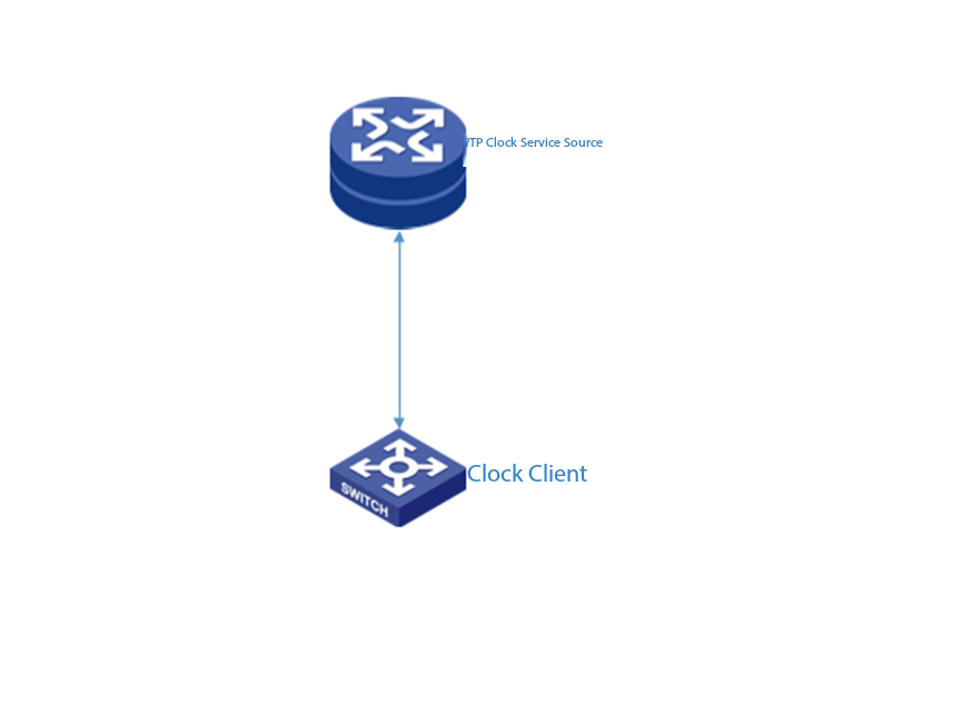

Network Topology
Problem Description
On-site PTP synchronization failed, client directly connected to clock source
