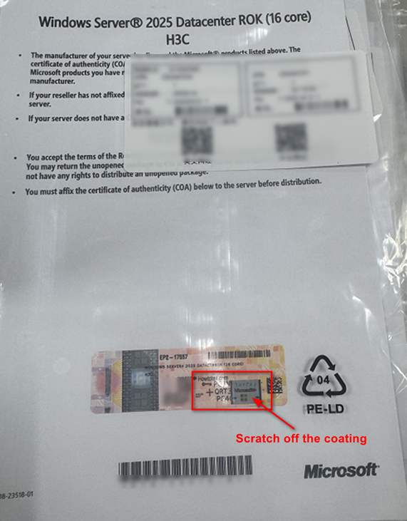

Get activation key as following:
To activate Windows Server using a product key, follow these steps:
