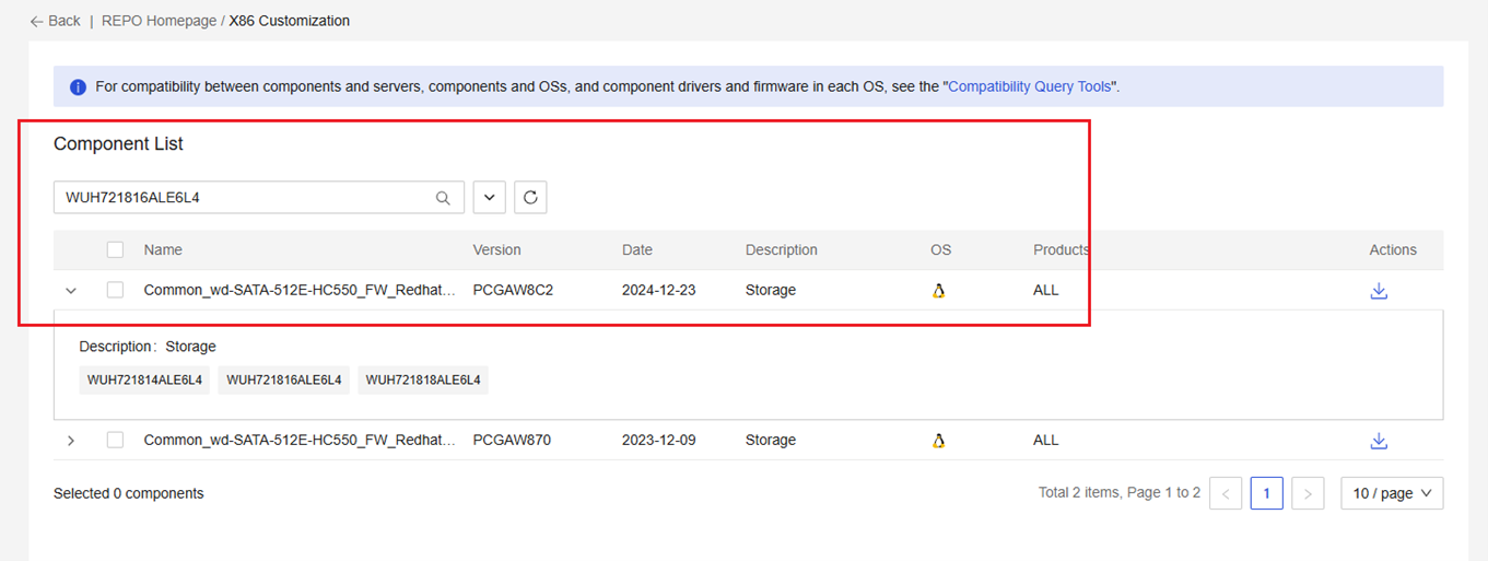

Involved Version
All firmware versions before PCGAW8C2.
Problem Description
WD Paris-C (WUH7218xxALE6L4) series 16T & 18T hard drives exhibit performance degradation or unexpected hard drive drops after prolonged use, leading to an increased failure rate.
Cause Analysis
There is an issue with the old version of the firmware. Currently, the latest firmware for the hard drive, PCGAW8C2, has been optimized to address this problem.
Workaround/Solutions
1.      Replace hard drives that have already reported a failure.
2.      For other hard drives that have not reported faults, it is recommended to upgrade the firmware to PCGAW8C2 to effectively reduce the hard drive failure rate.
Firmware link: https://supportrepo.h3c.com/home/x86?lang=en
