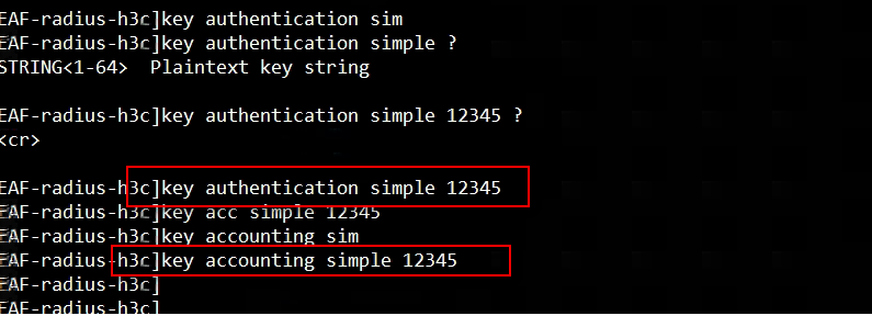

But we confirm that the shared key (12345) between the device and the EIA side has been reconfigured and is consistent.
In business parameter configuration-system configuration-system parameter configuration, change the "key display mode" to plain text, and then look at the shared key value corresponding to 192.168.40.2 in the access device on the iMC.
